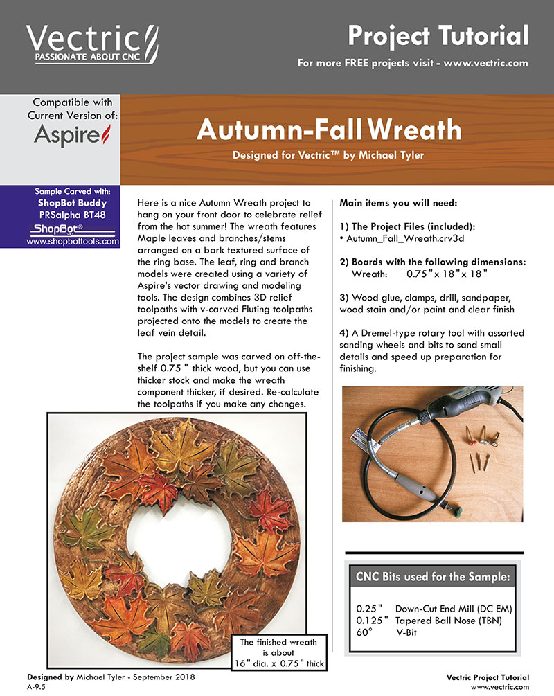

Here is a nice Autumn Wreath project to hang on your front door to celebrate relief from the hot summer! The wreath features Maple leaves and branches/stems
arranged on a bark textured surface of the ring base. The leaf, ring and branch models were created using a variety of Aspire’s vector drawing and modeling
tools. The design combines 3D relief toolpaths with v-carved Fluting toolpaths projected onto the models to create the leaf vein detail.
The project sample was carved on off-theshelf 0.75 ” thick wood, but you can use thicker stock and make the wreath component thicker, if desired. Re-calculate
the toolpaths if you make any changes.
