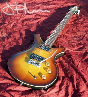

After the machining was finished the guitar body and neck underwent detailed finishing, grain filler, 3 coats of sealer and sunburst finish on front. Joel then applied multiple coats of lacquer with sanding in between followed by a 4 week curing period & final polishing. All hardware & electronics was then installed ready for set-up for playing.

Reviews of Joel’s guitars by both musicians & dealers alike have been very favourable. Fine instruments speak for themselves as sales have also proven.
