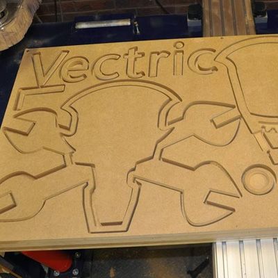

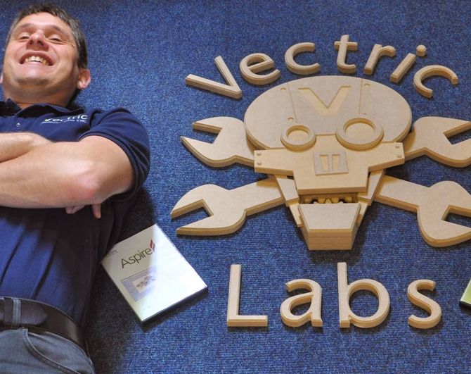

I exported the vectors from Inkscape as an eps file and imported them into Aspire and sent that to Brian. He split up the vectors into layered pieces and machined the design from a single sheet of 19mm MDF on the Shopbot Buddy he has in his garage that evening (did I mention we *love* CNC?).
By the time I came into the office the next morning, I could meet my finished design - 2ft across and looking great!
