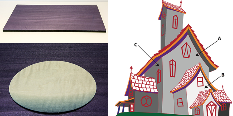

So, this project starts with a piece of black Valchromat 8mm thick. One side is veneered with a purple dyed poplar and the other side is balanced with plain poplar veneer so it does not warp or bend. Thus we have a simple board, in this case 400mm x 300mm (~15.75” x ~11.8”). Once the board is veneered it is sanded to 180 or 240 grit and then a coat of finish is applied - in my case I use a 2-pack spray lacquer and only put one coat on. Once cured it is denibbed with 400 grit paper. The finish is applied at this stage for two reasons, one is it helps bind the veneer fibres together so they cut better on the CNC and when the ‘moon’ is glued in, any excess glue is easily wiped off without leaving an unsightly glue patch.
The next job is to insert the moon. The moon is cut from bleached figured sycamore, I buy this in already bleached although it is possible to do yourself. Another approach is to cut a MDF template the size of the board with a hole where the moon is and simply spray white paint (or another colour) onto the board directly. I use the figured sycamore for contrast and the fabulous figure it lends the project. I also shade the bottom of the moon with black just lightly using an airbrush. This again adds more depth to the picture.
The Picture
This is quite a complicated looking picture but in essence it is reasonably straightforward. I tend to use Adobe Illustrator to create images like this because there are a lot of tools I can use to support my laziness. It is quite possible to do this in V-carve but I also use Astute plug-ins with illustrator because I find it makes it easier! Each of the roof, door and window sections (coloured red, orange and purple in the picture) are all V-carved with a 60 degree v-bit.

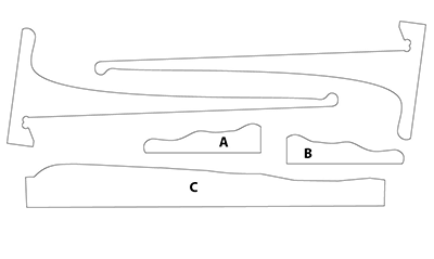

The stand is intended to hold the picture up and provide a platform for the LED lighting. The components for the stand are all cut from the same black Valchromat as used for the main picture.
The sections labelled A B and C will form the outside of the base of the stand and are textured using the texturing tool path in V-carve pro and the same 60 degree V-bit. Section C is textured to match the same texturing on the picture as closely as possible. The pieces are all cut out using a 5mm (~0.2") End Mill. I don’t tend to use tabs for this. Instead I like to leave about 0.2mm (~0.01") or so on the bottom. This saves my spoil board (I use 3mm or 1/8” MDF) and does not require a lot of cleanup. To release the components I turn the board over on the workbench and use an orbital sander with a 180 grit sanding pad and simply sand it out. This gives me a nice clean edge and it works quite well even for small components.
You will also need a piece for the base of the stand the width of the picture less two widths of the board (in my case 300mm - 2 x 9.5 = 281mm or ~11") and the depth of the stand upright - about 100mm (~4") in this case. The uprights are simply glued to the base and the textured side and front are similarly glued to the uprights and the base. the whole lot is held together by masking tape and lightly clamped to cure. Once the piece is glued up, you will notice that the edges of the sides do not match the texturing on the front. I rectify this using a v-groove gouge and just match the grooves across. Valchromat is a really good medium and carves quite cleanly.
