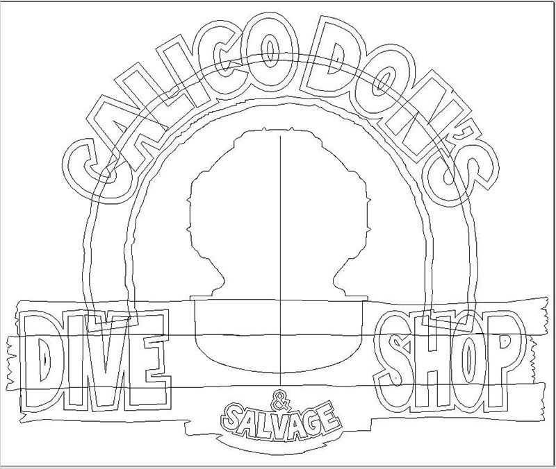

"Having Aspire makes the addition of themed signage an easy move for us. For the Dive Shop sign, I started with a sketch (left) that would serve as a solid foundation for the look of the sign which I imported as a basis for drawing all the vectors (below). I would then use these to build the individual components. Once I was happy with the overall look, I had 3 separate sections I needed to make: the sign backer, the helmet and the crab. In this instance I used our sub-d modeling program to generate the helmet portion (this is where Aspire's versatility shines as it plays very well with ALL of our other design software). The sign backer was then created using Aspire.

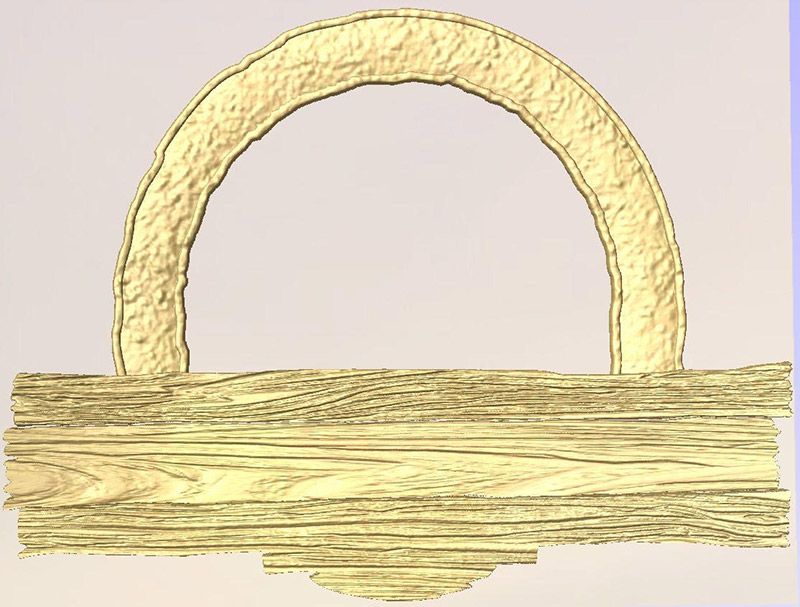

The thing that makes this style of sign stand out is the extreme use of textures (below). Every component has one form of texture or another applied to it.
The use of textures turns the job into a time versus results process. For a small general texture, this is done faster with a heavy bodied primer. For more extreme textures like the mottled brass hoop and rivets, and the wood-grain, bitmap images were used. It's safe to say that I've amassed quite a texture collection to date. For the wood planks I drew them as 3 separate boards so I could vary the heights and profiles to make them look like they had split away from each other over time. The trick was to imagine what a great sign design would have looked like years ago, and then add the effects of time to it. One of the most frequently used tools in Aspire for this was the 'create vector boundary' tool. When the helmet was imported, this tool gave me a vector outline that I could use to meld the helmet into the sign for a well fitted look.

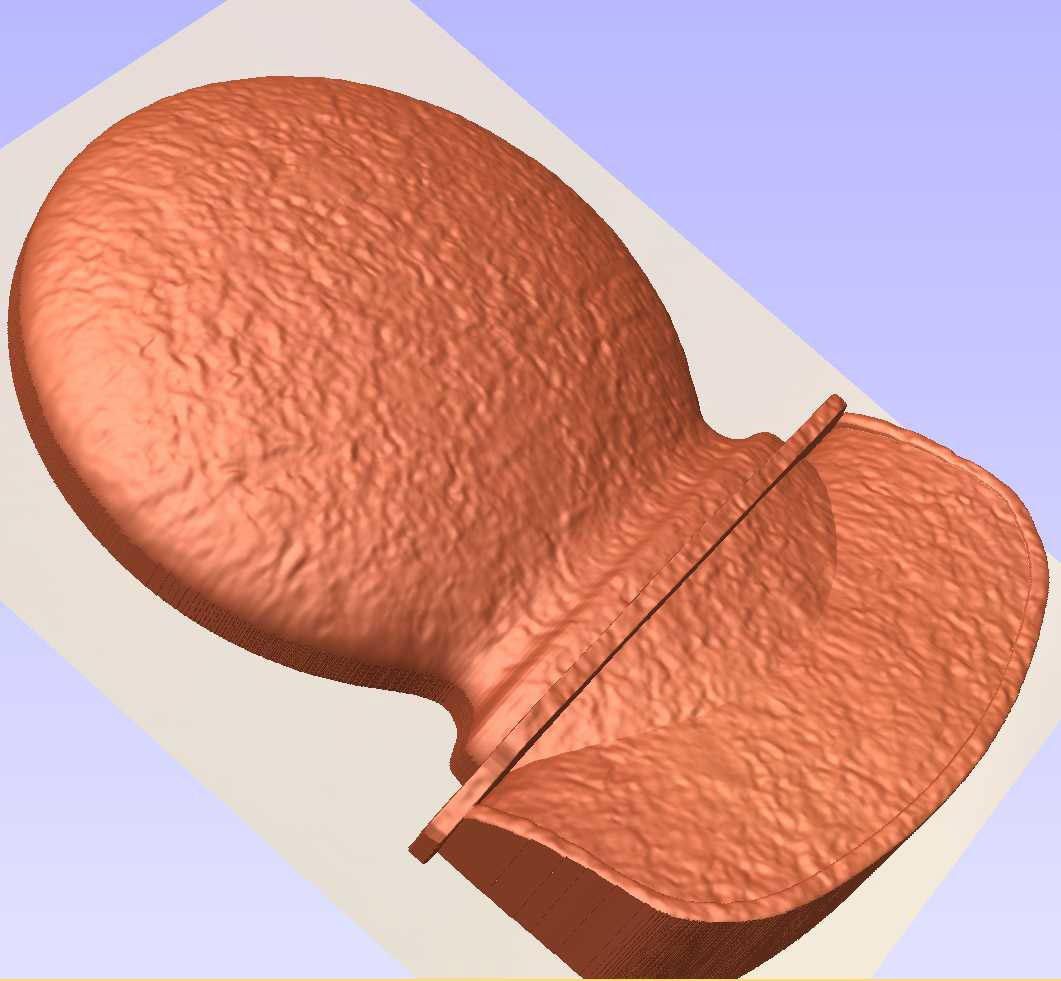

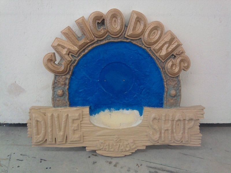

With Aspire, I was able to machine the helmet front and back, so it would have undercuts, making it read on the sign as a separate piece. This also got a mottled texture that we would paint so that it would look like heavily corroded brass, after all, this sign would be by the ocean. I also machined the portholes separately, making it look like individual pieces. This also made it faster and easier to apply the texture to the helmet portion. All of these details add to the depth of the sign which looks better to me than if I had just cut one big lump of a model with no undercuts. A little extra time at this stage makes for a finished piece that looks better than other 'bas relief' signs that seem to be the norm. When it was time for the painting, it was pretty straight forward. We started with the base colors, then applied multiple coats of paint and glaze mixed together. The glaze fills in all the bits of texture, and when partially wiped off, exposes the already dry base colors. This is the reason for all the texture we took the time to add. The crab (below) was completely hand sculpted from epoxy putty with metal armatures embedded for strength.
