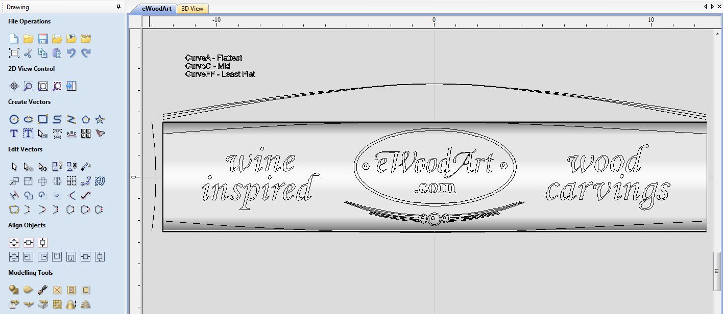

"We also offer custom signs and decorative plaques made from the curved side staves of barrels. We have not seen anything quite like ours in the market, probably because its fairly difficult to accurately produce carvings on a complex 3D curved surface at a relatively low price!
In this example I use our company logo stave sign as an example. It is carved on an extra wide 5" stave and includes intricate hand painting.
Here we leverage one of Aspire's most useful and elegant features: the ability to easily model a wide variety of complex 3D surfaces with the 2-rail sweep feature, coupled with the capability to project a design onto that surface.
We measure a stave's curvature along both its length and width, produce vectors for these curves and then use the 2-rail sweep to create the model. The screen shot below shows the required vectors in Aspire, including several stave length curves on top and width curves on the left. These can be used for the 2-rail sweep. Also shown are the stave outline and the carving vectors.
This next screen shot shows the "preview image" resulting from the 2 rail sweep with the V-Carved logo and text projected onto it.
One challenge with barrel staves is that they are fairly complex curves within 3D space, but the even bigger challenge is that no 2 staves have exactly the same curvature, even those from the same barrel! Even a small divergence of stave curvature from an ideal model can result in an inaccurate and flawed carving.
It would be far too expensive to individually model each stave's curvature and feed that into the production process. Our "secret" to resolving this is to generate a number of stave curvature model variants, from which we carve "curvature templates" out of plywood. We then fit each prospective stave blank against a set of these plywood templates and sort them into bins of known curvatures.
