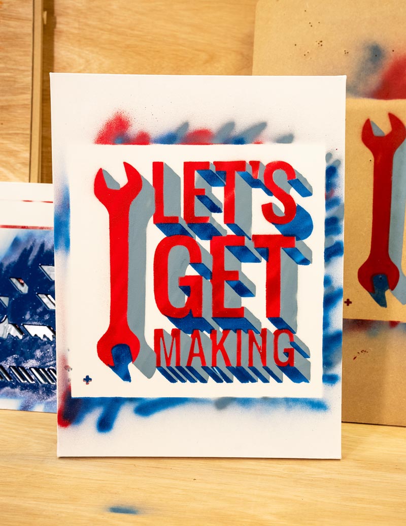

In this month’s “In The Labs” project, Olly shows us how to design and make an inspirational ‘Let’s Get Making’ 3D effect stencil kit. This multi-layer stencil kit uses Cut2D to give you the tools and concepts to make your own street art stencil for spraying onto canvas, clothing, walls or wood, in the workshop, on spoil boards or at a local event. Whether it’s wall art or wear art, get to grips with sprays and stencils and give your projects the graffiti art touch.
Olly will show you how he quickly makes this project from scratch, drawing the letters for his message individually using Cut2D. To create the spanner he downloads an image and traces over the bitmap to create vectors, using the snipping tool and node editing to delete overlaps. He then splits the design into layers for each color pallet and uses a piece of MDF to machine each stencil using profile machining with a 3mm v-bit tool. After sanding down the corners of each letter, Olly gets to grips with his sprays and stencils giving some upcycled wood and canvas his unique artistic touch. Get experimental and step outside the box to see how easy it is to use your CNC to create fantastic art projects. Find out how to create this FREE project and turn something you feel passionate about from 2D into super hot 3D art using just a font and an image.
