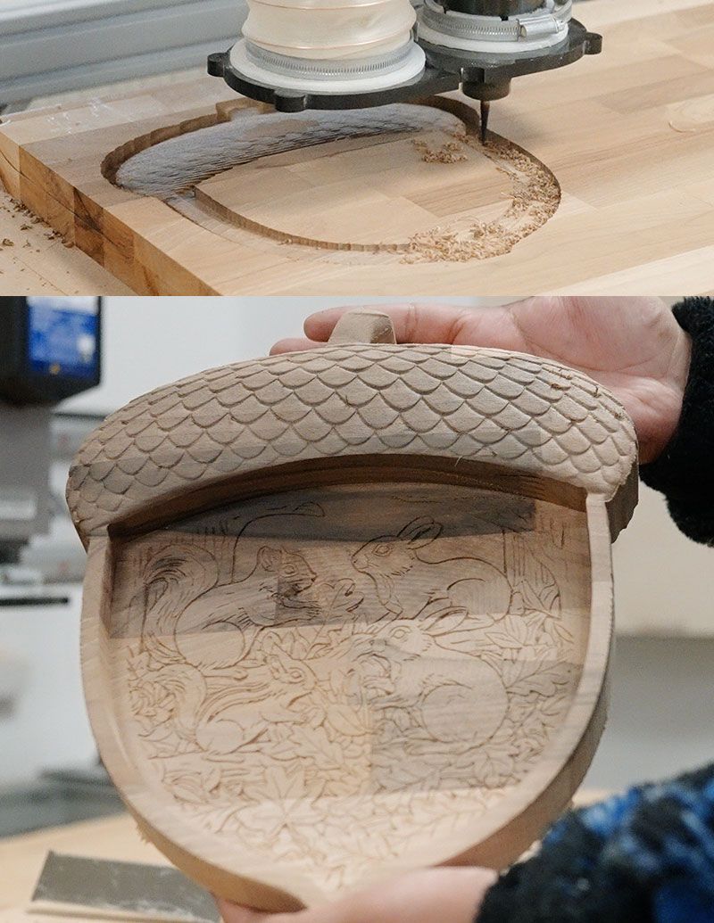

With the emergence of AI comes some really exciting and interesting implications for Vectric software. What better way to demonstrate this than to create a full 3D model using Vectric’s new AI tool to make a wonderful fall project. In this months “In The Labs” project, Nav shows us how to use Vectric’s EasyCreate AI tool to make a full 3D model, then bring it into the software to create a mix of 3D, 2D and Sketch Carving toolpaths to bring this fall snack tray to life.
Nav will demonstrate how to create the full 3D model using a prompt in the AI tool, how to get the model ready for downloading and how to import the model into the software. In the software, he will walk you through how to create vectors around and on the model, which aids to speed up toolpathing by limiting cutting to specific segments of the model.
Nav makes use of layers to organise his component and vector data, shows you how to use offsets to your advantage to help get clean borders and in turn how to utilise 2D toolpaths on a 3D model to help efficiently machine this project. He will finally show you how you can use the Sketch Carving toolpath (available in Vcarve and Aspire V12 products) to take a full 3D model and turn it into a sketch carving giving a lovely rustic, artistic feel to this practical and visually pleasing fall project.
This project uses upcycled wood from an off cut of counter top wood, which aids in giving a wonderful transition between the individual segments of the wood. Finally, be sure to use food safe stains for any finishing on this project so you can serve up your fall treats in style and safety.
