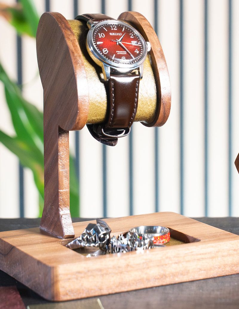

Everyone loves a good watch. A good watch can be timeless and elegant. Whether it was the first watch you purchased or one that has been passed down through the generations, every watch needs a solid resting place when not being worn proudly. That’s where this months luxury watch holder project comes in.
Nav is a big fan of watches himself and wanted to create a project that showcases his love for time pieces but with added practicality. To do that he made a watch holder which displays the watch at an angle, with a useful catch all tray right underneath to house any other worn items, such as rings, earrings or maybe you need a nice resting place for your car keys.
The project itself utilises the clip art that comes with the full license of VCarve Pro and Aspire to create the watch holder segment itself, so you don’t even need your own model. Nav will walk through how he created the vectors for the body of the holder, and crucially how to setup vectors for the dragknife toolpath that was used to cut the leather for the watch holder and catch all tray.
