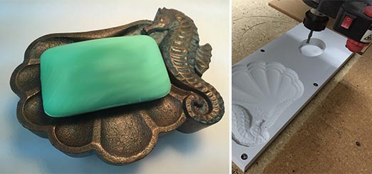

This deep sea inspired soap dish is an easy to make project, carved and cut from 1" x 6" PVC trim board material found at any home center store. The sample imitates a thick-cast bronze metal block with a shallow shell motif dish and a seahorse ornament complimenting the oceanic theme. It is coated with thick bodied metallic paints and a patina applied to yield an aged appearance. Hidden weight (BB pellets) inside the block assembly gives a “heft” to add to the illusion it is made of cast metal.
The finished dimensions of this project are approximately 6.4" W x 4.4" D x 1.45" T
