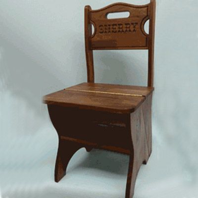

Since their interest in CNC, Dale has mentored his neighbors for three years as they continue to develop their woodworking hobby. During Christmas 2010 he was asked by them if he could demonstrate how to build a chair/step ladder. The timing of the project was ideal as it provided a good reason to upgrade his CNC to the new welded design Artisan frame and provide Legacy with feedback on its performance. The concept of a combined chair and step ladder is one that Dale remembered seeing in an old catalog and with a bit of research he was able to develop his own design. The final version was a customizable chair/step ladder that would be fit for any home. Dale concluded our brief interview by giving us an overview of the process and this is followed by the project files and his instructions for making your own version of the design.
"When I started the project I got my dimensional guides from an old oak chair and a step ladder. I then created the project in TurboCad so I could rotate the ladder to verify it's fit, stability, and aesthetics.

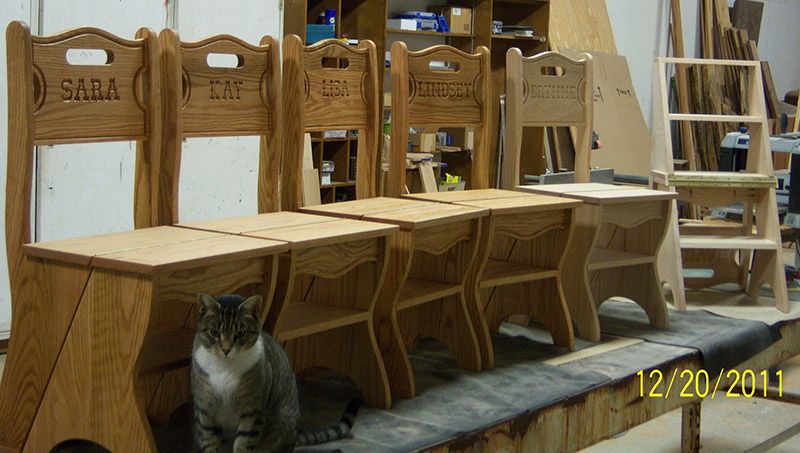

Aspire was then used to create the finishing touches on the project and to generate the toolpaths. The first four chair/step ladders I finished were very well received at Christmas, so leading into Christmas 2011 we produced six more chairs and received requests for six more, including orders from my wife and daughter!
Ten of the completed chairs are northern red oak and two are black walnut. All the chairs are finished with Circa 1850 Teak/Tung Oil from Jamestown distributing."

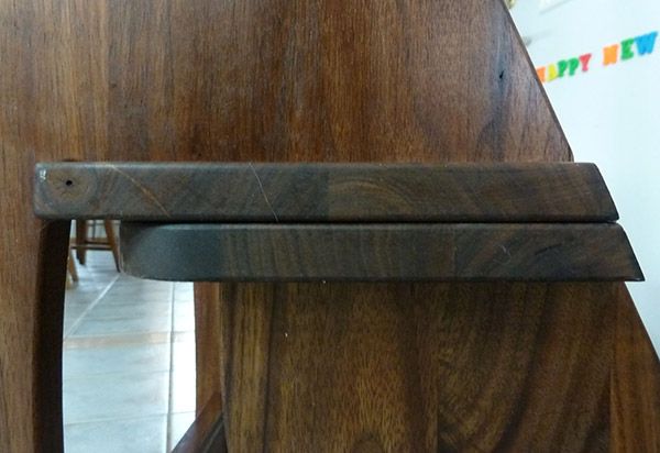

  • NOTE: It is not necessary to use a piano hinge. Use the hinge(s) of your choice as long as the chair/ladder functions properly. When in the ladder position you don't want your weight supported by the hinge screws, so ensure there is a zero gap between the front and back seats when folded up.

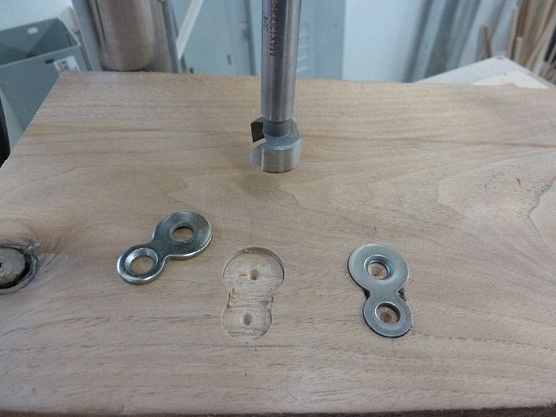

When attaching the figure-8 bracket ensure the holes are 1/8" deep, both holes need to be cut in the bottom of the seats with two Forstner bits to match the size of the figure-8 brackets.

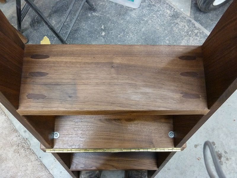

Firstly fasten the figure-8 bracket to the chair with #8 x 1-1/8" screws and then to the seats with #8 x 5/8" screws. There are two figure-8 brackets in the front seat positioned approximately 1" from the back edge, plus two pocket screws in the stretcher. The back seat has 4-each figure-8 brackets placed approximately 1" from the front and back edges.
Pocket screw holes and screw holes that are exposed in the ladder position are plugged. I make my own dowels with a Veritas dowel maker then cut them to shape with a band saw.

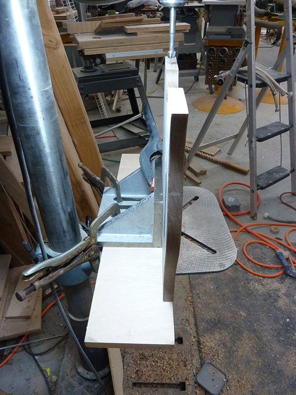

Creating the Dowels
When creating the dowels I use a machinist angle which is clamped to my drill press table. This also aligns the holes front to back in a straight line making it much easier to align the holes.
Tips:
  • Make certain your dowel holes do not cut into your v-carving.
  • When measuring always use the same tape and always measure from the same starting place. With dowels there is no room for accumulative or subtractive measuring errors that always happen when measuring from hole to hole.

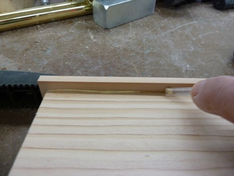

  • When gluing you will find that torn strips of paper towel strips suck-up glue without smearing. Plastic drinking straws scoop up (or suck-up) glue in corner joints. Put strips of cotton rags in water with a little lemon dish soap, wring tightly and wipe up excess glue (the soap helps remove the glue without harming the finish to be applied later. Round tooth picks also work great when gluing holes.
Drilling Straight Hole: To drill an effective and straight hole use a Forstner or brad point bit.

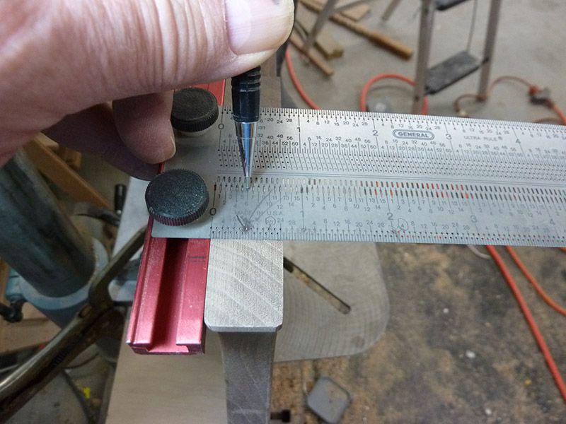

Dowel Hole Location: Draw a line at the hole center parallel to the back edge. Insert the pins into the holes in the chair/ladder sides, now align the first and last pin on the line scribed on the back. Alternatively you could use an Incra stainless rule that uses a 5mm pencil. After using a 5mm pencil it is a good idea to use a sharp center punch or ice pick to mark the exact center spot before drilling. When using dowels the holes typically must be within 1/64th inch of center.

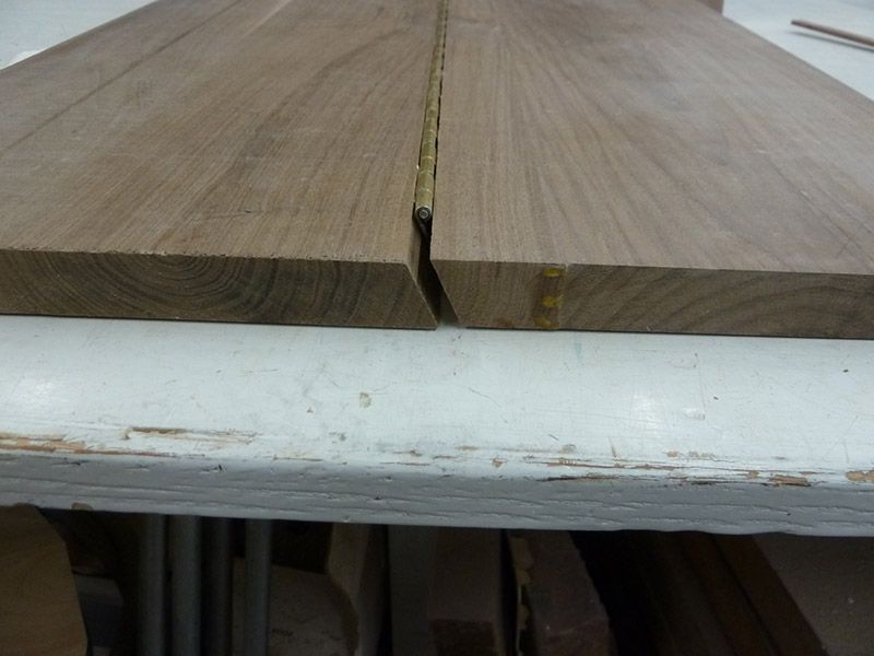

Installing the Hinge
NOTE: To prevent the end of the screws from poking out it may be necessary to drill at a slight angle towards the center of the boards. Tips:
  • NEVER USE BRASS SCREWS on a chair or a ladder. Use yellow zinc plated or brass plated steel screws to prevent screw failure under load. It may be necessary to counter sink the holes in the hinge if the screw heads stick out too much. You only have 1/32" clearance for the screw head when the seat is in the chair position.
  • Most screws have a single thread which can cause the screw to push to one side of the pilot hole. To prevent misalignment push the screw into the pilot hole hard to force the screw shank to the center of the pilot hole. Hold the screw down tightly until the screw thread is started. Once you tighten a few screws in strategic places you can lift up the hinge enough to remove the double sided tape without losing alignment.

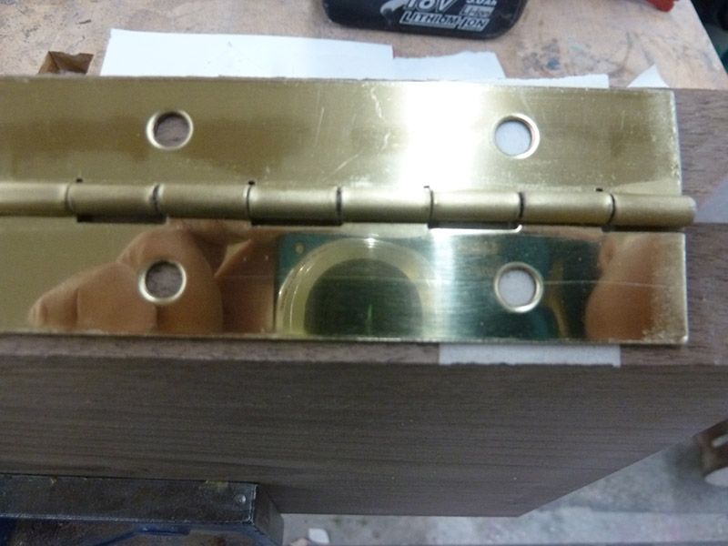

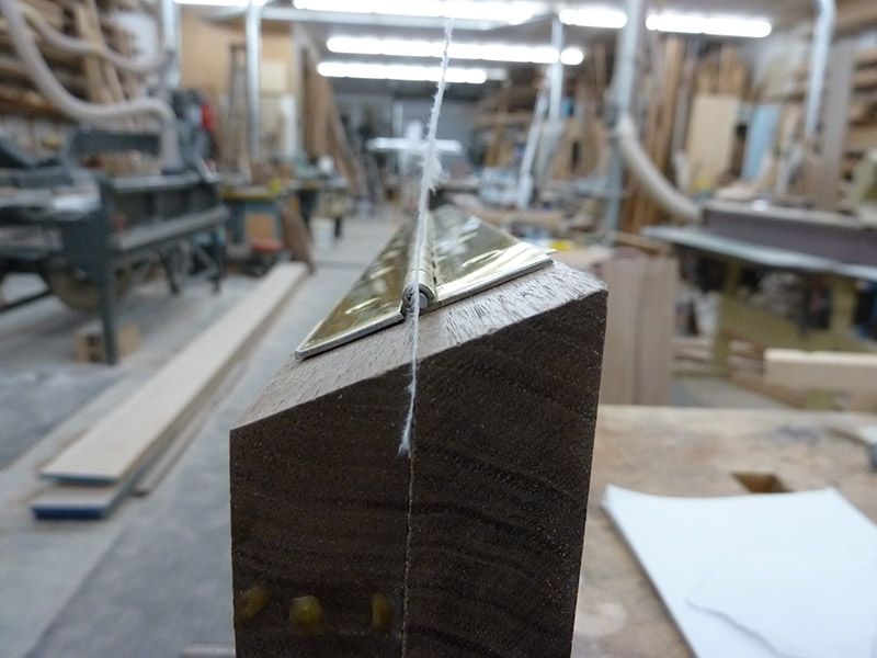

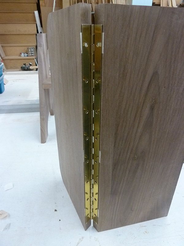

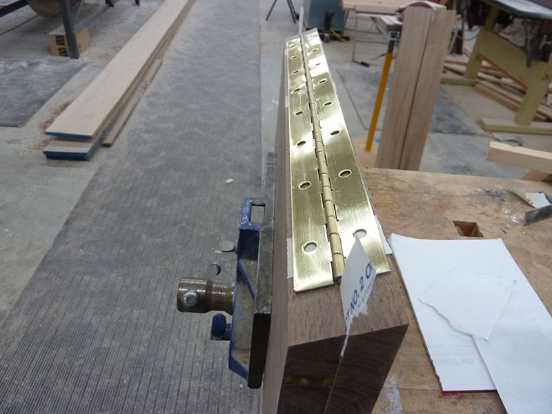

Firstly align the two seat halves face to face and clamp them loosely. Mark the ends of the hinge location and slip a small piece of paper up to the hinge line on each end then finish clamping them together.
Next put 3 short pieces of double-sided carpet tape on each half of the seat within the hinge area. Align the hinge with the pin centered on the edge of the paper and press onto the double-sided tape. The hinge pin must be centered in line with the faces of the seat.
Test the seat before adding screws to verify its alignment. When the seat is opened it must be flat, when closed the two faces should be in contact with each other. Use a vix or snappy self centering bit to center and drill pilot screw holes.
