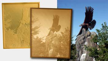

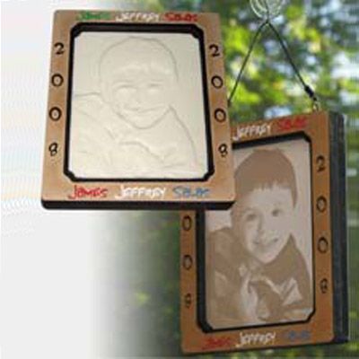

When cutting the lithophanes Greg uses a 0.125" diameter ball nose for the roughing toolpaths and a 0.0625 diameter ball nose with 15% stepover for the finishing.
Greg sandwiches the lithophanes between the two cutouts of mdf, paints the text using regular acrylic paints. Then adds a few clear coats to seal to the frame and also to the corian, which brings a nice luster to the lithophane.

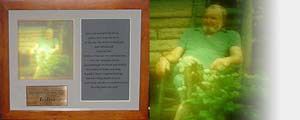

Robert Davis has used the technique to machine a fabulous permanent momento for his mother-in-law, and added a professional finish by adding a frame and back-light.
