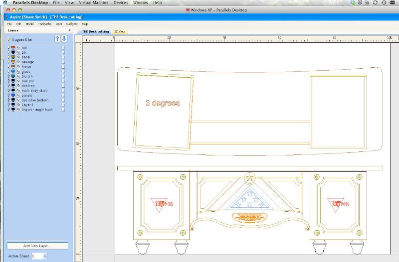

"I got this job because our sales team and another colleague, Rob (the Veteran), wanted to surprise one of our customers who has been more than supportive to us. Rob wanted to gift him his flag from Afghanistan and some of the sales team wanted to surprise him with a desk - that's where I came in. They asked me to design what turned out to be the desk you can see in the pictures.
For this job I used a style that I started to add to show booths, like the Parkey's Taxidermy Sign below. The style mixes woods like walnut, mahogany and in this case wormy maple. I love the contrast and the others involved also liked the idea of me mixing the woods.
One of the coolest things that unfortunately didn't turn out on this desk was that I designed the feet to be a turned bun style foot that you can see in the first Aspire screenshot (above left). This design actually inspired me to hook up an indexer to my CNC. Being new to the indexer, along with the time constraints we had on this job, meant that I didn't have time to learn everything I needed to about indexing to achieve the look I was going for. Therefore the feet ended up a squared tapered foot. It still looks great and since finishing the table I have turned some cool pieces thanks to Aspire."

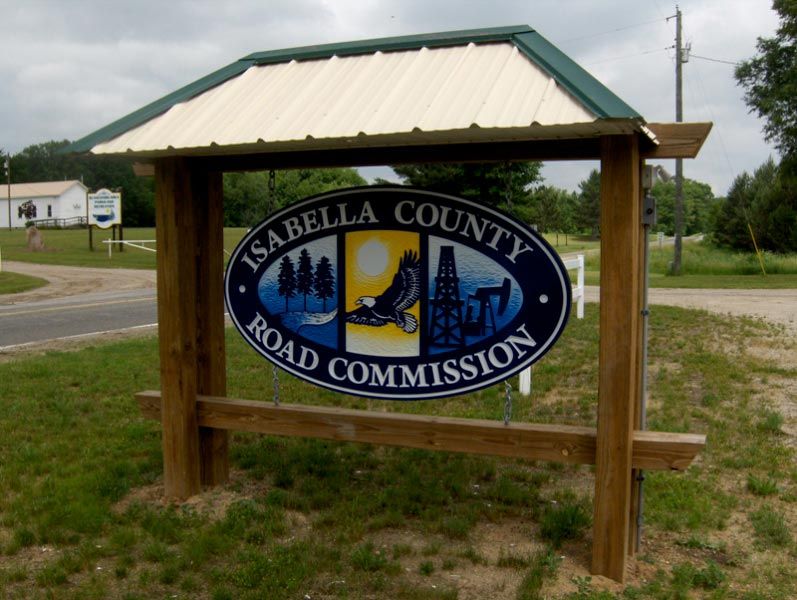

Isabella County Road Commission Sign
"This job is one from my afterhours gig. I do the odd sign every now and again and this specific client found me after seeing my other work from around the area.
This design was a logo the client used on the trucks and they wanted a sign to match. Similar to the Parkey's sign, I just had to '3D it up'.
The sign was made from HDU Sign Foam then painted with One Shot and spray paint for the fades. The coolest part of this project was figuring out how to create the texture behind the sun. Aspire does a great job creating the hand sculpted look along a line, but I wanted the texture to actually wrap around the sun. It took some editing, but what I did was create a bunch of random circles that got larger as they go out from the sun and then added some nodes and deleted spans. Then I used the Texture Tool path using selected vectors as pattern and that gave me an awesome sun effect. The finished sign measures 72" x 40"."
