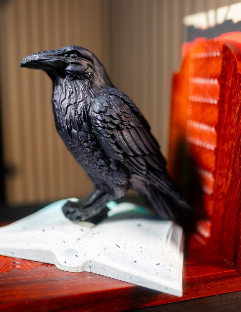

World Book Day is just around the corner, and there’s no better way to celebrate your love of reading than with a beautifully crafted book end.
In this month’s project, Nav guides you step-by-step through the creation of the Raven Book End — a striking and practical design that keeps your books neatly supported while making a bold visual statement. Along the way, Nav demonstrates how to use the slicing tool to divide a 3D model into three separate sections, allowing you to work efficiently with material that is thinner than the original model thickness. He also shows how to create a clear and organised layout using sheets, making it easy to manage the various materials involved.
You’ll learn how to combine both 2D and 3D toolpath strategies for efficient machining, as well as a selection of finishing techniques that truly bring the project to life. The design features upcycled Corian off-cuts paired with two contrasting wood species, creating a distinctive layered effect, enhanced with subtle lighting and dry-brushing for added character and depth.
This project is also fully customisable. Simply swap out the raven for a design of your choice — perhaps an apple for the bookworm in your family, a 3D heart for a book-loving Valentine, or something darker to embrace spooky Halloween vibes. With easy-to-use slicing techniques, you’re never limited by material thickness, giving you complete creative freedom.
