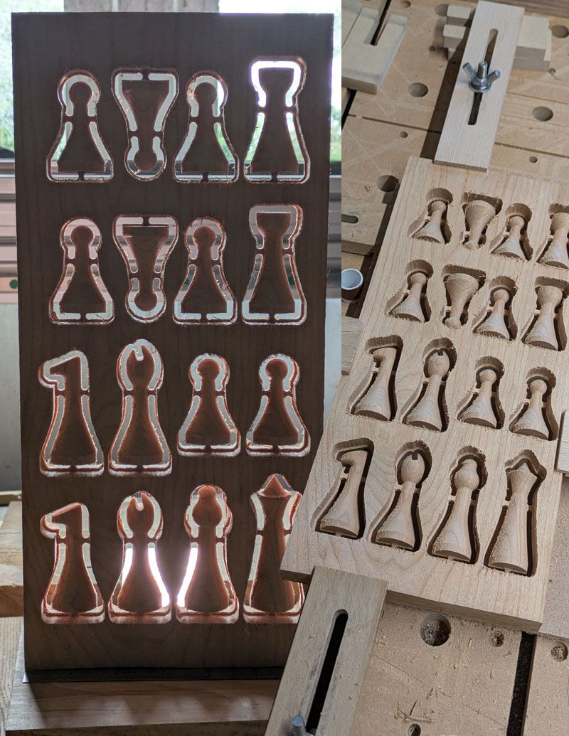

Forum contributor Dave Hebson has crafted a stunning minimalist chess set using Vectric Aspire and a double-sided CNC machining process to ensure perfect symmetry and surface consistency across every piece.
Machined from beautiful cherry wood, this elegant design combines clean geometry with subtle detail, resulting in a modern take on a timeless classic.
Most of the pieces were modelled using Aspire’s Vector Turning Tool, allowing for smooth, flowing forms that capture the essence of traditional chess shapes. The knight’s distinctive head was sculpted with precision using the 2-Rail Sweep feature — a clever technique that defines the horse’s contours with grace and balance.
To achieve flawless results, Dave refined each toolpath with boundary vectors, and used a ball nose (BN) cutter for the final profile cuts, ensuring crisp edges and preventing chipping.
Whether you’re a CNC hobbyist or a seasoned Aspire user, this project is a brilliant showcase of creative design, precise machining, and smart toolpath strategy.
Download the project files for free and bring this minimalist chess set to life in your own workshop!
Tools Used
- 3.175 mm Endmill – primary roughing
- 2 mm Ball Nose – initial finishing pass
Features Used
Spin for most of the pieces
2 rail sweep for the knights head
