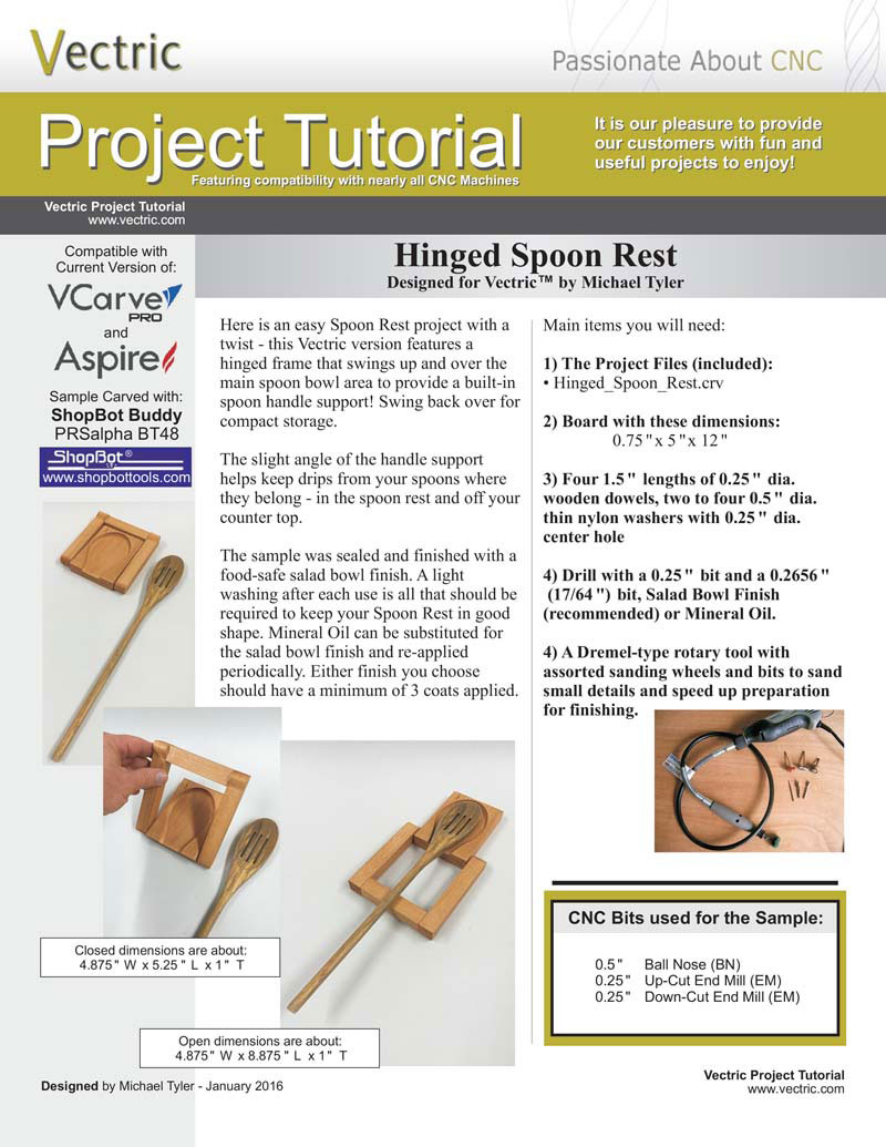

For this month's project Michael Tyler has created an easy to make Spoon Rest project with a twist. This Vectric version features a hinged frame that swings up and over the bowl area to provide a built-in spoon handle support! Swing back over for compact storage. The slight angle of the handle support will help to keep drips from your spoons where they belong, in the spoon rest and off your counter top.
Closed dimensions (approx): 4.875 " W x 5.25 " L x 1 " T
Open dimensions (approx): 4.875 " W x 8.875 " L x 1 " T
