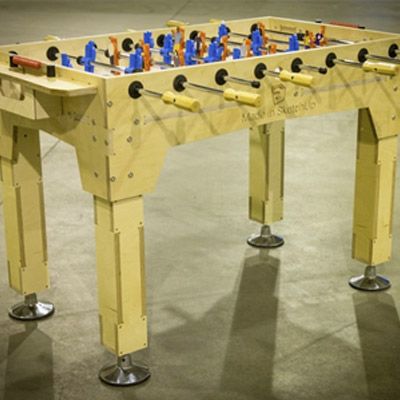

The Foosball table was designed to be a fun way to show how one could combine different mediums together to create one super cool project. This particular project combined CNC milling, 3D printing and vinyl graphics. I designed the whole thing in sketchup. I use the sketchup models in vcarve (which I was using at the time I made this) to create the toolpaths, the graphics were designed in sketchup sent to the vinyl printer, and finally I used the 3D models of the foosball players to send to my 3D printer. After I milled and printed all of the parts, they all fit together exactly as I intended them to. This only worked because of the accuracy of the digital tools I used throughout.
The CNC milling took a few hours. Then there was sanding and finish time. Assembling the plywood actually was quite easy. I like to use bolted connections for things to make them easy to assemble, and easy to modify afterwards. The 3D printing took about 80+ hours to complete, and the vinyl printing took just a few hours. After I had all the parts together assembly took about 2 hours. Now that I’ve done it before it can go together in about 15 minutes. This foosball table travels around and I’ve got it setup in a special shipping crate so that we can pull it out of the box and be playing in just a few minutes. I milled these on a shopbot PRS standard so I did 3 passes with a compression bit at 4 inches per second. The 3D printed players were done with 5 shells and 50% infill so they’d be strong. Baltic birch plywood for the body, PLA filament for the 3D printed players, lacquer for the finish and vinyl for the playfield. The rods and other hardware were sourced from Thompson game supply.
There were two important features within Aspire that I had used for this project (and many other projects I have made) The sketchup import is key to making these as the whole design was made there. After it was imported using the dog bone feature is indespensible. I’d like to take this time to thank sketchup because they funded the project and gave me the creative latitude to do it. Outside of that it was totally designed and built by me. You can read more about it on their website.
The final assembly went spectacularly. I expected there to be the moment where I’d find out all sorts of things were either wrong, or needed a lot of hand work to fix. Because I carefully designed it, and I created all of the parts using digital tools it all worked out. I think the real key to this working, aside from using the digital tools was to measure and draw absolutely everything. Even down to the bolt heads, it was all drawn in sketchup so I could check all of the clearances. Sure, the feet didn’t really needed to be modeled here because I bought the as an off the shelf item, but having them in my 3D model helped inform how I positioned the legs. Modeling everything else let me see how each and every part worked together.
In the future I think I’d get more 3D printers to pull off a project like this. My single (old) makerbot worked around the clock for over 80 hours to print these. After the very last player was printed it broke down. I’ve since gotten a few extra printers so that when I do a project like this again, I have backup machines and I can produce the parts quicker.
