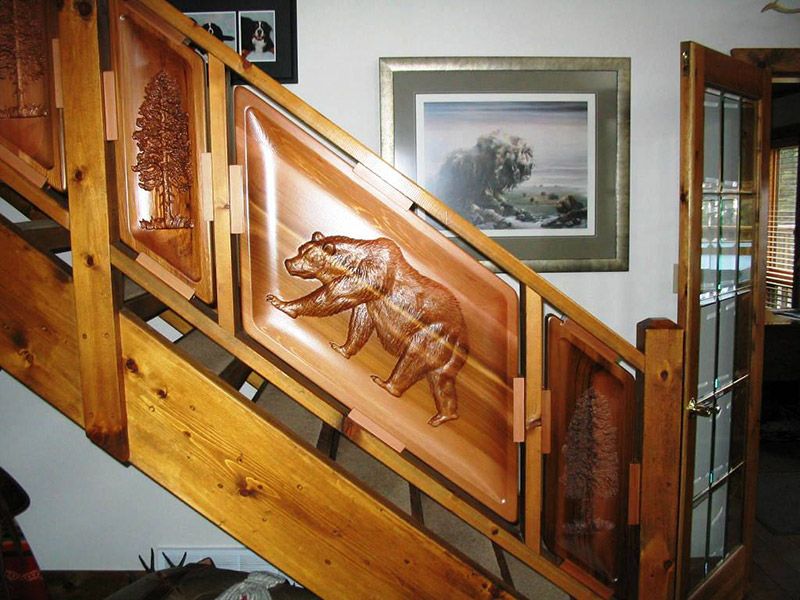

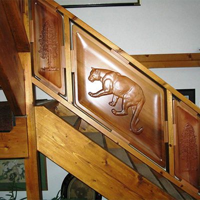

"The stairway project was actually broken down into two separate undertakings. Working with the clients we came to the decision the panels going up the stairs would be individual scenes of animals and trees, while the balcony area would be one continuous scene. So other than trying to decide what animal and tree went where on the stairways; it was actually a pretty straight forward design process. However before cutting these panels I did cut two small sample panels to make sure the cutting parameters I planned on using would actually work as well as, that the quality of finishing satisfied the client's expectations."

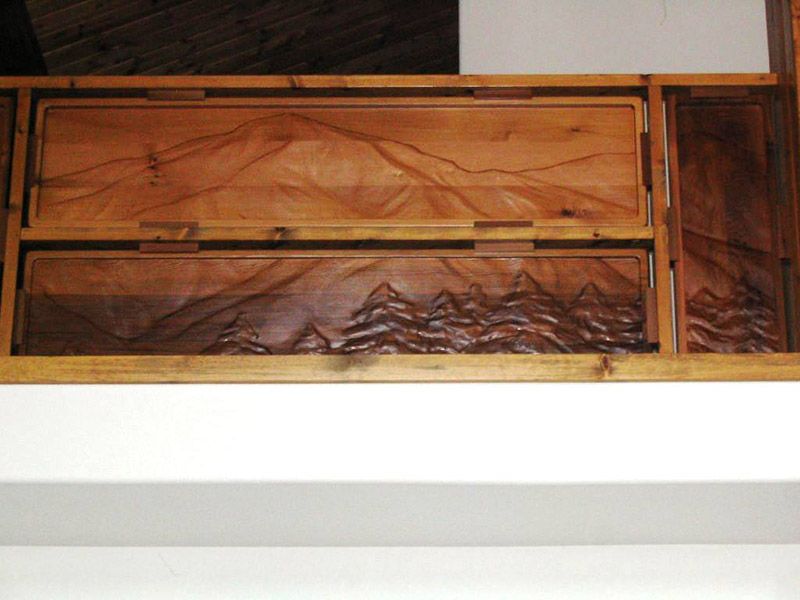

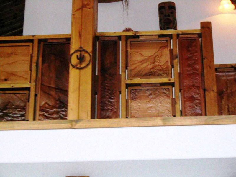

"The mountain scene for the balcony railings required a lot more thought to ensure that the scene flowed across the entire length of the railing and with a depth of only 3/4", that there was enough relief in the carvings to bring out the details when viewed from the ground floor. So after much thought I came up with this process. I first drew the existing railings and posts full scale in a CAD program then imported that drawing into Aspire as a separate layer. Calculated the overall workspace need for the model scene and then started to make a 3D model of mountains and forest that would fit into that workspace. I used this large model when talking with the client to make sure they had good idea what the overall scene would look like. Using Aspire's sculpting tools, plus the fade, tilt features, etc. and some of Vector Art 3D's models I was able to create an overall scene that the client liked. I then used the railing/post drawing layer as a template to define the boundaries of the individual panels that were then turned into individual cutting files for the router. The one thing I had not counted on during the design process was how the light streaming through the windows would actually enhance the relief of certain panels at various times through the day."
